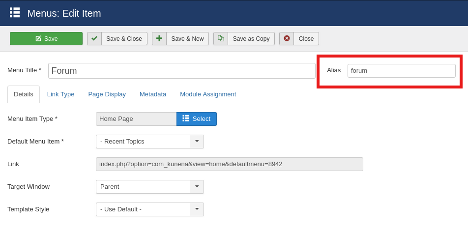

8 years 1 month ago #204398 by rich
Replied by rich on topic Link Issue
Your menu items are ok now. Please empty your caches (Joomla and Browser-cache) and try again.
Yet, the issue persists. Btw. I've noticed something else. Previously, there were links pointing to "index.php/forum/" instead of "index.php/kunena/". The part that is actually appended to the links is the highlighted part (bold).
It shows the word in the address which is entered in the first Kunena menu item "Forum" as alias name (see image).

8 years 1 month ago #204401 by rich
We are using the URL BB Code for this.
1. What happens, if you use the link without bbcode or if you click on a message number? Is the link in principle wrong?
2. Have you menu items in the trash? This can also cause errors.
3. A problem is for me, because I can't see your page.
