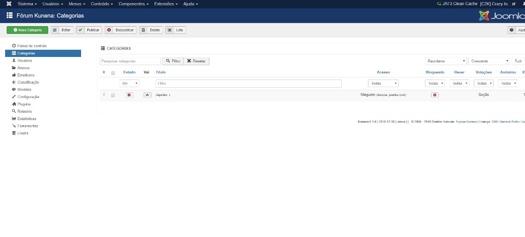

Currently I updated Kunena to version 5.1.8 and after that I did not move any more in kunena, after a few days I needed to add a category and by my surprise disappeared all the existing categories in kunena.

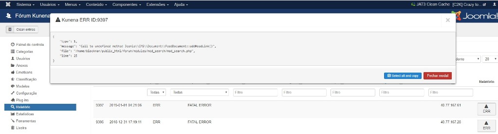

So I logged into the kunena report and I came across a very large log with the same error that I'll be putting here for you.
"type": 1,
"message": "Call to undefined method Joomla\\CMS\\Document\\FeedDocument::addHeadLink()",
"file": "/home/blacknan/public_html/forum/modules/mod_search/mod_search.php",
"line": 25
I wonder if anyone could help me solve this problem?
I am already using the latest version of Joomla.
Thank you!

7 years 9 months ago #206766 by 9themestore
Please try to visit this link to solve the hide category issue.
The following user(s) said Thank You: bondrj
7 years 9 months ago #206767 by bondrj
Hi thank you very much!!
I was able to solve the problem of categories having disappeared.
Could you tell me how I can solve the problem of the error that I showed in print?
ERRO:
"type": 1,
"line": 25
