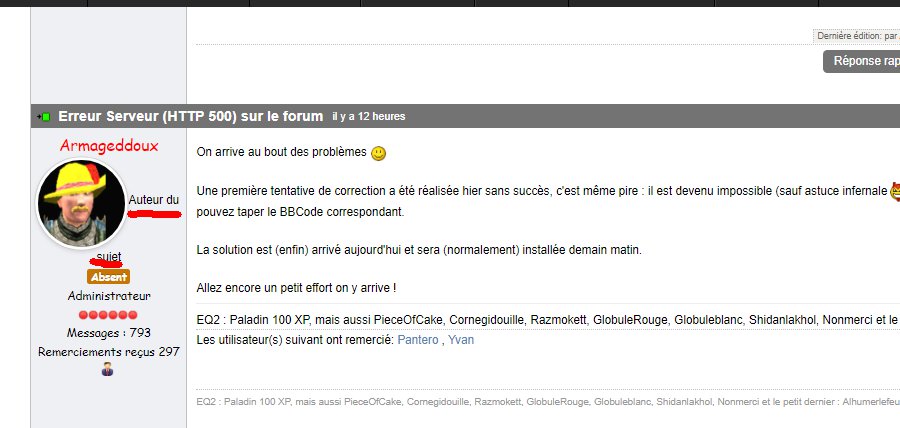

Found a slight bug in displya for rc3 showed on the joined
screenshot
Seems this is due to the html statement :
<span class="hidden-phone topic-starter topic-starter-circle">Auteur du sujet</span>
replacing <span> by <div> works fine (tested in chrome) same result with inserting a <br/> before <span> item
