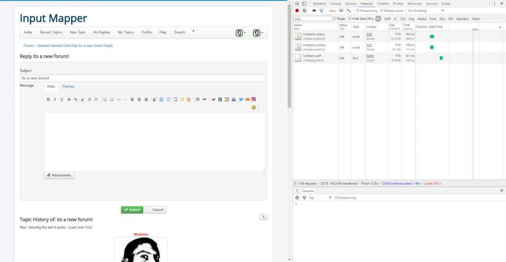

jhebbel wrote: And fyi, mootools is loading on your site aswell when you reply... so thats not it.
On the main website, yes. Because its still J2.5 and K4.X
On our stage site, we have no mootools anymore. You can also see my other test site: www.newf1.nl

Its your editor that loading the mootools anyway, so I cannot disable it.

Sorry but it is, and it looks to be the editor as it only loads when using the full reply and the editor is visible, even protostar did this, but again, its the POST that is slow, not GET, moo tools nor any other js library loads during the post as it is just PHP and DB, so can we get past the runaround with the libraries and start looking at what could be slowing it down in a large DB possibly?
