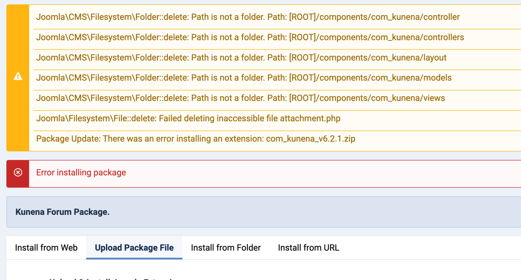

I upgraded my site to Joomla 4. I erroneously made the assumption that I could just install K6 on top of K5. But now I've created a situation where I'm in limbo. I'm currently running Joomla 4.4. When I try to uninstall K5 files, i get notified that it can only be done in Joomla 3. If I try to install K6, I get error messages and it won't install. Is there a way to unravel the mess I've created without reverting back to Joomla 3?

I changed .htaccess of the "mm4" folder to point the root to the "mm4" folder, but the error messages (see pic in first post) show "[ROOT]/administrator..." Could that be why it's not installing correctly? Is the installation not recognizing that the "root" is in "mm4"?

You also need a path to a temporary (tmp) folder, otherwise you will not be able to install Kunena.
