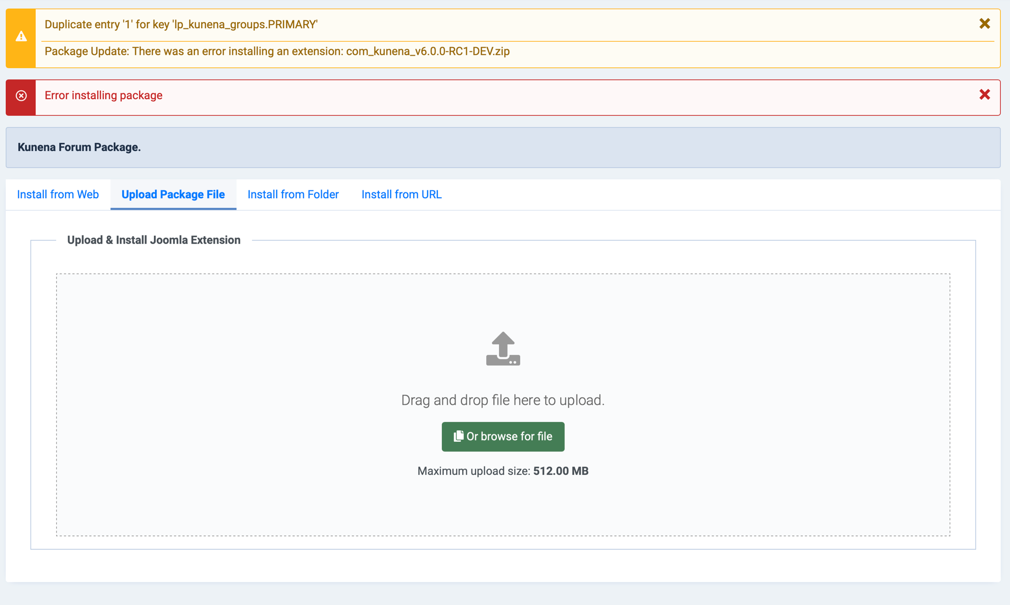

Question Plugin Issue: with latest build of CB integration
4 years 9 months ago #222012 by xillibit
Try with the new nightly build from today
4 years 9 months ago #222043 by cursulak
Sorry I still get the error using pkg_kunena_v6.0.0-RC1-DEV_2022-02-16.

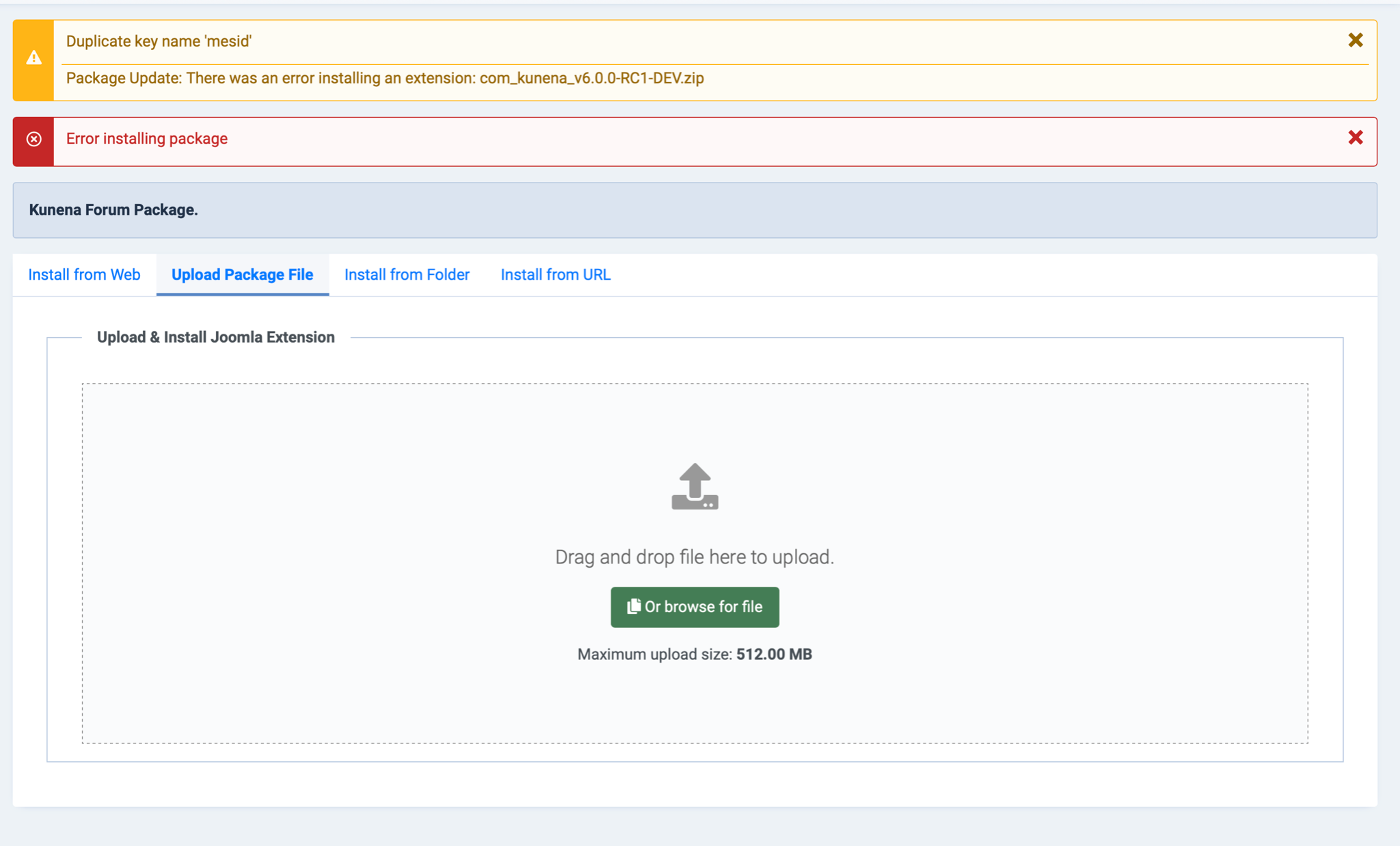

Interestingly, if I try and run the installer more than once, I get different errors.... Here is error second run. I didn't run it again. Not sure if that means anything.
4 years 9 months ago #222067 by xillibit
It's weird because the table #__kunena_groups doesn't exist in Kunena since a while
4 years 9 months ago #222163 by cursulak
Maybe an old hook in the code somewhere that got overlooked? or am I the only one getting this? have you had other reports?
This seems like more of a mysql issue, but I could remove the directory structure and do a reinstall to see if it clears anything. Clearing the DB on the otherhand I don't want to do.
Sorry if I take a while to respond, the notification feature doesn't seem to tell me when there's been a response.
4 years 9 months ago #222176 by xillibit
For the issue which say JInstaller: :Install: Error SQL Duplicate entry '1' for key 'PRIMARY', we are able to reproduce it : github.com/Kunena/Kunena-Forum/issues/8841
It's weird because actually there is nothing in the code about the table #__kunena_groups
4 years 8 months ago #222307 by xillibit
Try with the RC1 just released, the upgrade process has been changed becasue was broken
