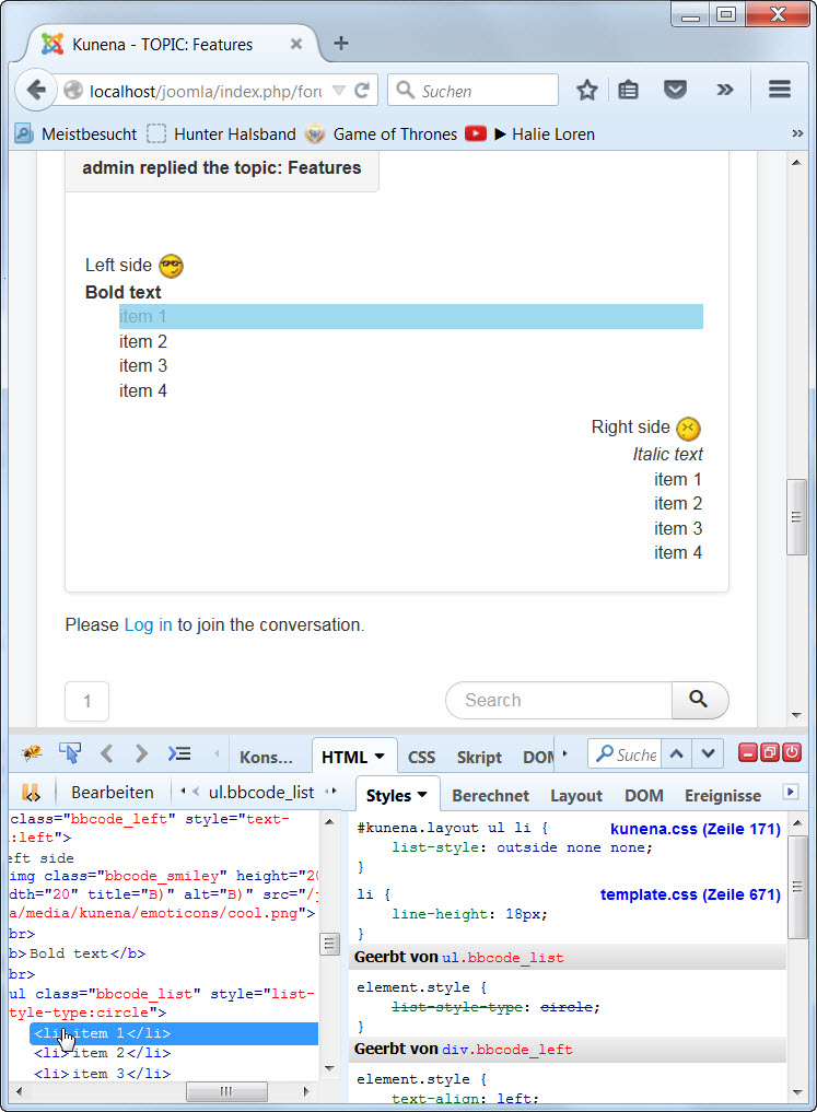

There seems a css rule which hides the symbols.

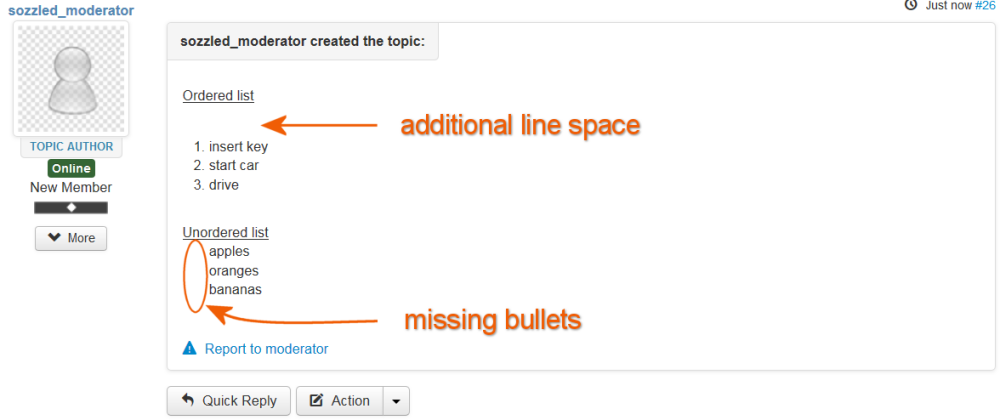

There are several issues with list items.
1) The BBcode parser for Crypsis creates additional line-breaks if you select some lines of text and press the OL or UL button (as mentioned by Ruud in msg #1 of this topic.
2) In my case (on a standard Joomla 3.4.1 website using the Protostar template) the numbered list-style works as expected, but the bullets are absent on ULs.
This is the BBcode I used:
[u]Ordered list[/u] [ol=1] [li]insert key[/li] [li]start car[/li] [li]drive[/li] [/ol] [u]Unordered list[/u] [ul] [li]apples[/li] [li]oranges[/li] [li]bananas[/li] [/ul]
This is how it appears (in Crypsis):

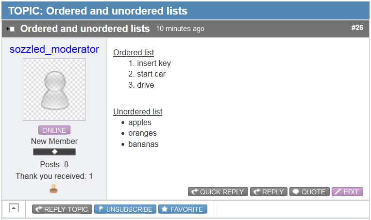

With Blue Eagle, the lists work as expected:
The problem is that there is only one single CSS definition for all list styles in the K 4.0.1 Crypsis template (at line 171 of kunena.css):
#kunena.layout ul li { list-style: outside none none; }
If you change this definition, the whole Crypsis template falls apart.
