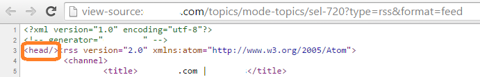

11 years 1 month ago #168750 by ssh
I think that maybe by removing the <head/> tag could fix the problem.
Can you please confirm that? or tell me where to remove the tag?
Thanks in advance

11 years 1 month ago #168756 by ssh
I know this is the file, but I don't know what to change
11 years 1 month ago #168764 by ssh
Seems like this tag <head/> is coming from other file, because I have tested the rss by replacing the view.feed.php with older version of kunena (3.01, 3.06) and the problem persist.
Any idea?
11 years 1 month ago #168765 by 810
<head/> comes from joomla template.
we have just 1 head in our component. thats in the error page.
The rest we load the head by joomla.
I don't see the error on k.org
11 years 1 month ago #168766 by ssh
I am just assuming this is the cause of the problem, but if you already know the solution for this problem I will appreciate your help as usual.
