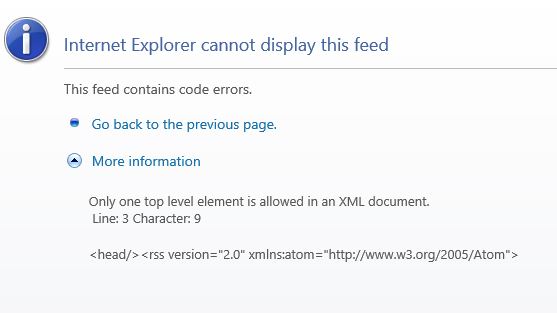

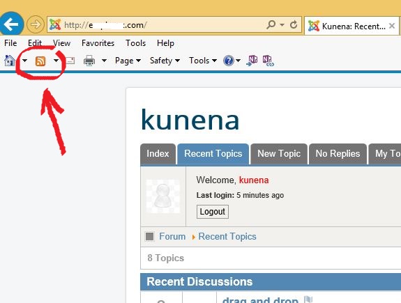

If I click this button:
I get this error:
This only happens with a website that was migrated from 3.0.8 to 4
In a new blank installation, there is no error, BUT, content from feed are not being displayed, so, this feature is not working properly.
This error is on Blue Eagle Only K4.0.0B3 DEV,

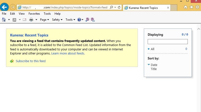

11 years 5 months ago - 11 years 5 months ago #165141 by ssh
xillibit wrote: I have tried to reproduce this issue but i wasn't able
1. Set default template to Blue Eagle
2. Open Internet Explorer 11.0.9600.17801 or similar version
3. Login into the forum with any account (Maybe this is the step you are missing, because i didn't mentioned before)
4. Click on the RSS Button
4. You Should see NO content, you should see something like this:
Last edit: 11 years 5 months ago by ssh.
