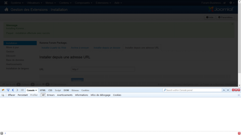

With firebug can-you check what you see when you launch installation of Kunena ?
11 years 11 months ago #158435 by François59

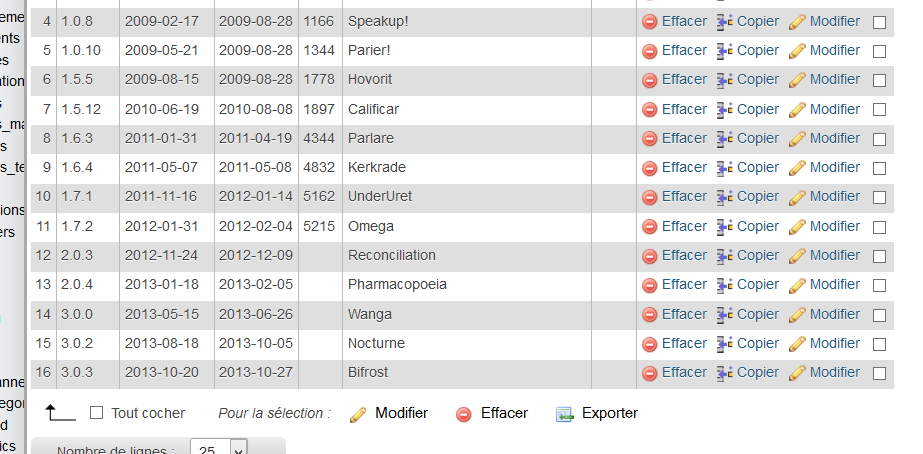

P.S. : in the table __kunena_vesion what do-you have for the last line :

About Kunena_Version :
