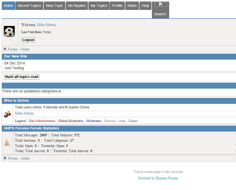

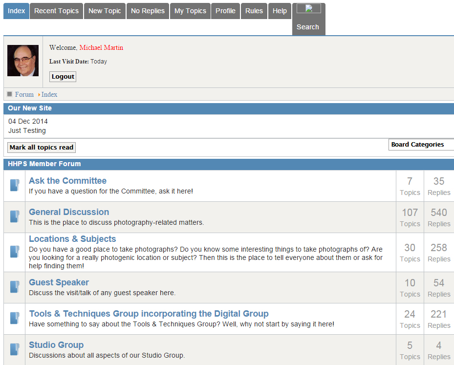

11 years 9 months ago #161228 by mightec
Hi
I am using CB 2.0.4 and Kunera 3.0.6, as far as I can see all plugins are enabled, etc as I can get the system to work if I am login as an Administrator, but not as a registered user.
If I am logged in as the administrator I get the forum page as seen in attachment 1.
If I am logged in as a registered user I get the forum page as seen in attachment 2.
All the permissions are set to the default settings, if I change the permission for the registered users to administrator I get the form page as seen in attachment 1.
