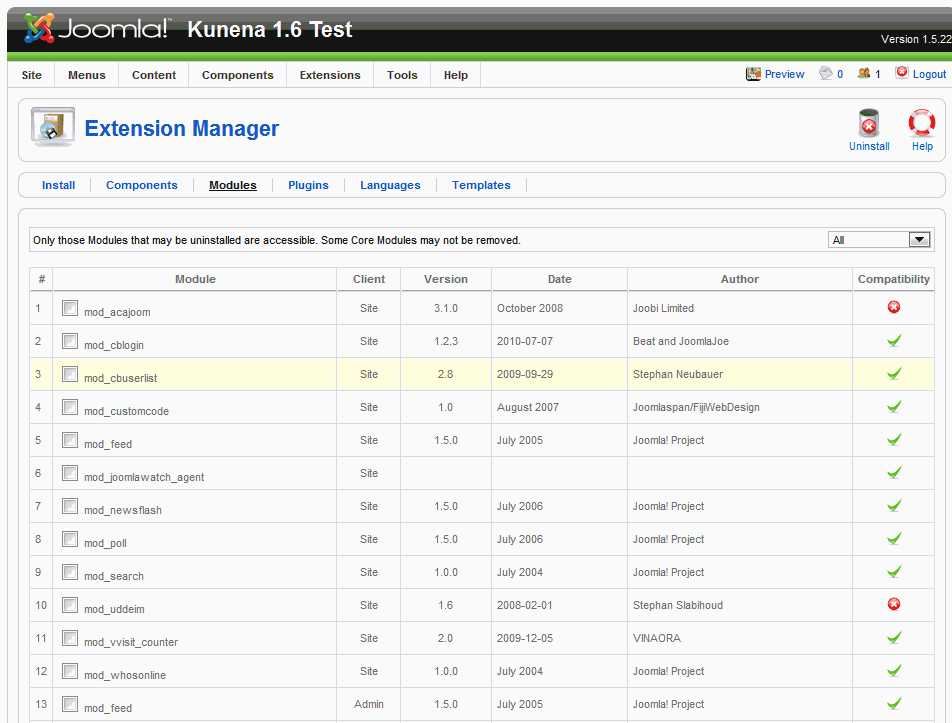

The screen shot you showed comes as no surprise to me at all.
Here is one for you (screen shot take a few minutes ago) J! 1.5.22 running without the System - Legacy plugin enabled.
As you see, I have two modules that Joomla describes as not "compatible" but I have no troubles running without the System - Legacy plugin enabled.
Why not end this argument, disable the legacy plugin and see if your fears were correct?
