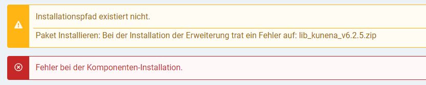

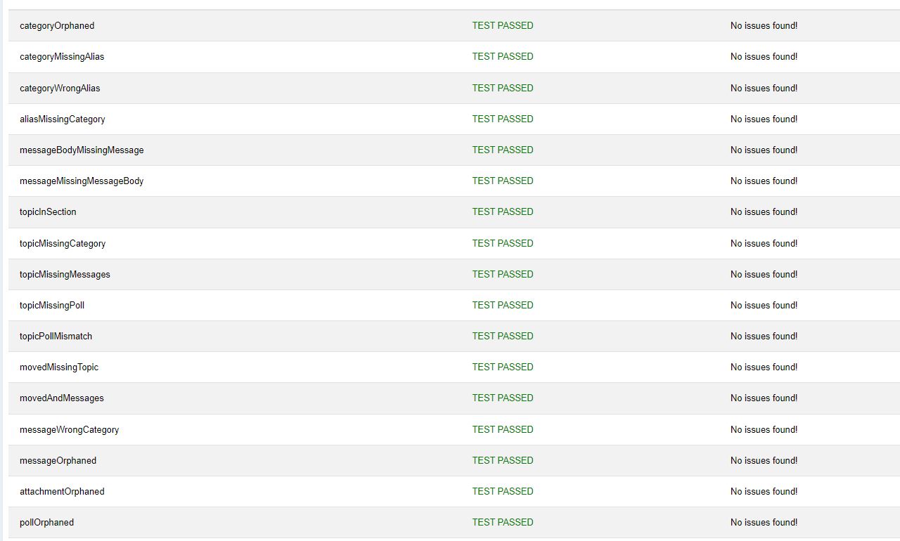

Thanks a lot for the detailed answer... sadly not worked. :/ I even tried searching for any "Kunena"-Files via console and nothing found in the end.

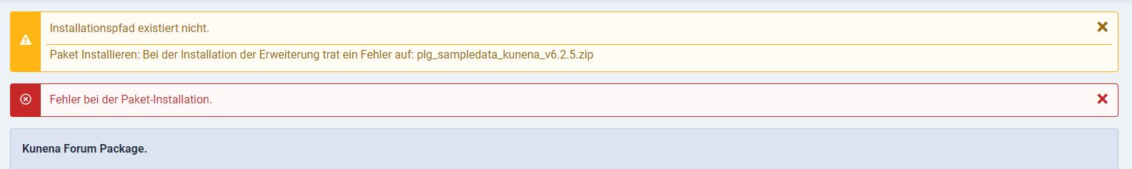

Used Kunena 6.2.5 with Joomla 4.4.3... PHP 8.2.16,  MySQLi 10.6.15-MariaDB-log. Here are screenshots and a link to the page. I have no ideas now to be honest... If I can fix the issue manually I will do. Or is there anything I am missing? Maybe a missing plugin or something I have to activate manually?
Edit: Just tested what happens when I activate all the KUNENA Plugins.. then it also show different files missing, like in the last screenshot. For better debugging, I activate just the necessary Plugins again. So everything that stands here, is now Status Quo.
The installation fails with this error:  "Installation Path does not exist"
But Component is present in Backend then, also the checkup says everything is fine.

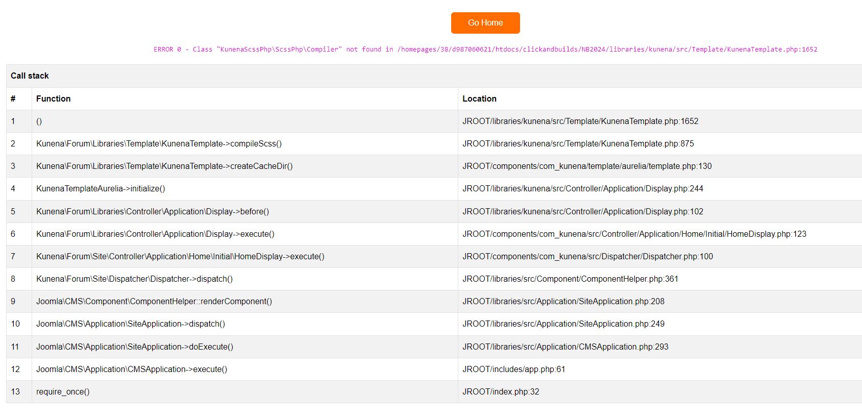

But when I call..
https://musikmagazin-saarland.de/index.php/forum?view=home&defaultmenu=651
same error as before: Class "KunenaScssPhp\ScssPhp\Compiler" not found
Error Stack:
Last edit: 2 years 8 months ago by pschwindling.

The installation always stops at the sampledata plugin. This means that the installation runs until then. Does the installation also stop if you try to install this plugin separately? You can find it in the installation package.

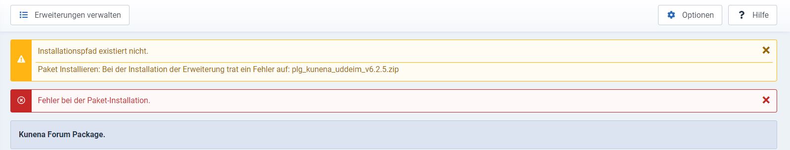

2 years 8 months ago - 2 years 8 months ago #231060 by pschwindling
Hey hey,
tried to install the sample-data first. And then install the forum plugin again...
then it says "uddeim" has a problem.
Tried to install the uddeim from the packages folder and then install the forum... but then he always says:
So.. what if I upload the folder with the unzipped package and remove those packages and trying to install the plugin from that folder with the removed packages? Maybe an idea? because the single installation of those packages work. you know how I mean?

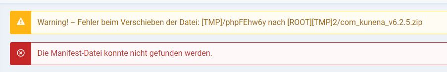

Edit: Sadly that does not work.. when I remove the package where he has the error (uddeim) - also in the pkg_kunena.xml... (two lines)... this error shows up then:
Edit 2: Sorry... pure madness. I should start writing here, when my ideas are at the endpoint again. From the latest error, I tried to install the com_kunena_v6.2.5.zip from the packages folder. Now this comes up, and when I clear the cache it only says "Mainfest file not found":
