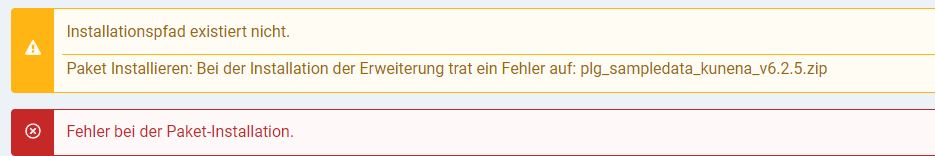

Sadly this won't work... no matter how I uninstall Kunena (also with the manually search for extensions and remove).. this error always comes up when i try to reinstall.
"Install path does not exist"
I have it in the component menu after that error.. but cannot install the "Language Pack" for example..
Also tried clean cache and stuff after uninstallation. No success so far. Looks like something is broken now because my migration trying before maybe. It is only with the Kunena Extension so far. Other extensions work, so I do not think that it has something to do with permissions.
