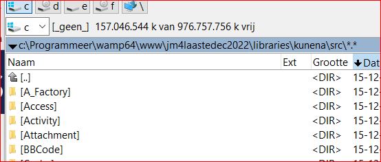

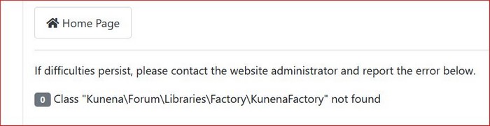

3 years 11 months ago #226961 by Leen
I can only explain that somehow that folder is not accessible to kunena.
If I rename the folder here as a test, I do indeed see that error
With kind regards
Leen
3 years 11 months ago #226963 by davidpoole
I have no access to any part of the Kunena installation, Every link in the admin panel for Kunena, provides the same failed message.
I am running php8.2 on a standard linux server hosting through a datacentre.
Any suggestions on how to get this working at all??

3 years 11 months ago - 3 years 11 months ago #226973 by davidpoole
managed to get it all installed now. My mistake as i only installed the component and not everything else!!
