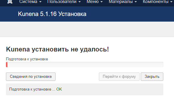

6 years 8 months ago - 6 years 8 months ago #212530 by Александр
An error occurred while trying to install. Joomla control panel is locked.

6 years 8 months ago #212546 by Александр
Good afternoon!
Nothing helps. When installing, such a situation occurs as shown in the screenshot. and at this moment stops
6 years 7 months ago #212551 by rich
Please try the following:
Start the installation and when the installation stood still, go to \administrator\components\com_kunena and remove the install.php
Then refresh in the backend the page.
See also here: www.kunena.org/forum/installation-issues...-install-from-5-1-15
