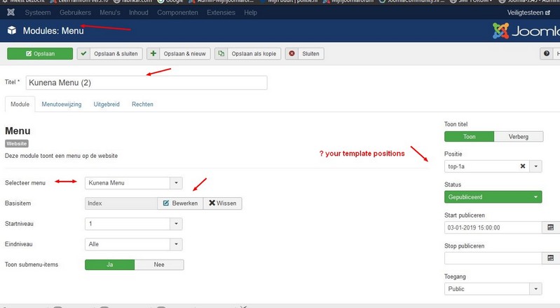

6 years 7 months ago #212135 by Leen
I think you have to create a new module
in joomla module management and module type menu
and there you can then choose the basic menu and also the menu
where to start.
You just have to put it in the right position depending on your template positions.
With kind regards
Leen

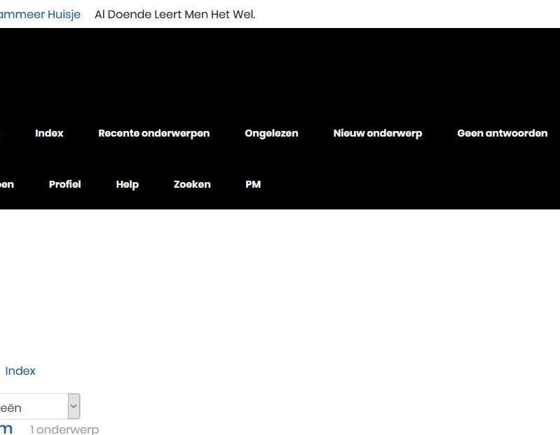

6 years 7 months ago #212138 by nhoj050789
Its shows like this when I tried the module position I want it to be exact same on the original www.screencast.com/t/d0bqEsnLl

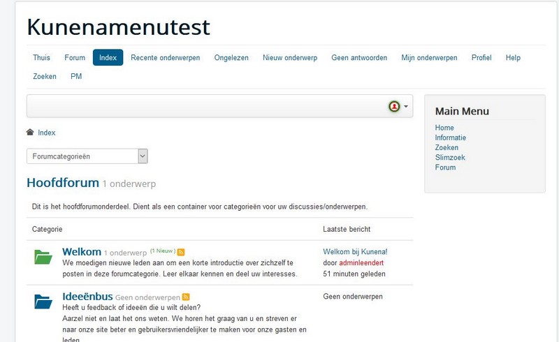

6 years 7 months ago - 6 years 7 months ago #212154 by Leen
When I create my own new menu and this exactly
the same as Kunena's.
and then add it to the menu option of a template, it seems to work nicely.
But if I add it to a new menu module and in a different position. I get a vertical menu again.
With kind regards
Leen

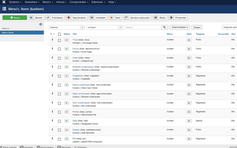

6 years 7 months ago #212163 by rich
Instead of its original position inside the kunena template but its showing a different looks and the login/profile on the right side is not showing when I tried to put it on module position
The login form is not a menu item therefore you have this not in a copy of the menu. If you want the Kunena menu on top, why don't you move it via CSS to this position? As you can see in this forum here we have placed the menu on the fix top position.
Also the kunena menu is working fine on other page but on the other page its showing blank
I think you use Kunena menu items in other menus. Please see this docs:
docs.kunena.org/en/troubleshooting/menu-issues
docs.kunena.org/en/faq/kunena-menu
