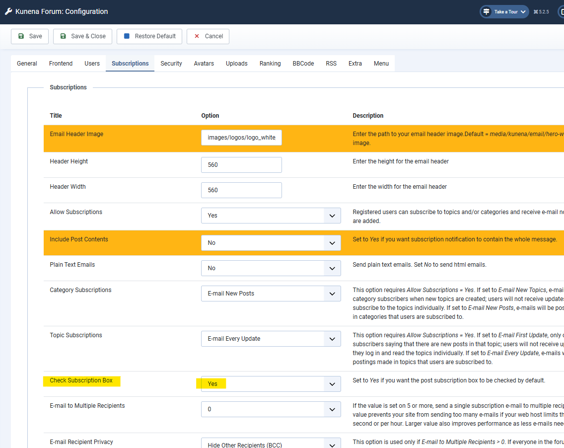

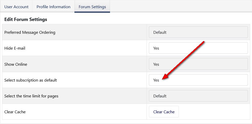

@Pinkeltje these are my account settings. Looks like it takes the forum default which is set to "yes" in the forum configuration. I see plenty of evidence that I'm subscribed to both topics and categories.
