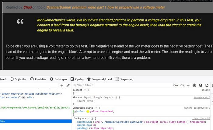

It's always a lot of searching to find out what you mean
without a link but I know which website is meant
Try this code in Kunena Forum: Templates custum.scss
#kunena.layout blockquote {
color: black; }

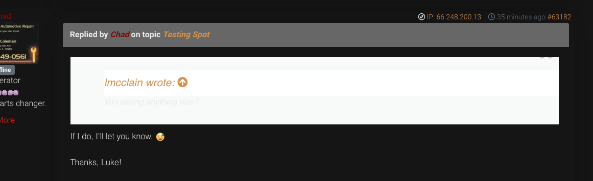

2 years 11 months ago #229516
by lmcclain
Replied by lmcclain on topic Block quote color not able to be seen.
Sorry about that.
scannerdanner.com/forum.html
I put that code into the scss--->custom and it's still the same.

2 years 11 months ago #229517
by rich
Replied by rich on topic Block quote color not able to be seen.
.kmsgtext-quote {
color: #000;

Replied by Leen on topic Block quote color not able to be seen.
ha I think I gave the wrong color try this one or make color white
.kmsgtext-quote {
color: yellow !important;
