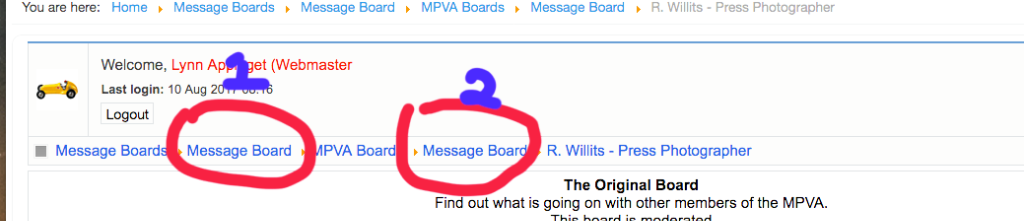

So there are two issues,
1. the bread crumbs (both joomla and the kunena) add an extra link which goes to the same place (note #1 and #2)
So Message Boards is just the forum link and the top section (i only have 1) is the mpva-boards with the first board being Message Board
Message Boards is a menu alias to the kunena menu and message Board is a kuena category

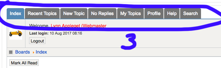

2 the second part is why does the forum menu go away on any page but the menu alias's how do I get it to show for the boards and topic pages? - I actually had this working at one point then I started to try and fix the bread crumbs (I deleted all board menu items and rebuilt) and now it does not work

if I go to another board the breadcrumbs and the kunena tabs work okay (I wold like to change the kunena tabs though)
9 years 3 months ago #194460 by lappleget
#3 - I have figured that part out. need to publish those category views in the kunena menu and unpublish the ones I don't want.
But with only the top message board as a menu alias in the joomla menu I still have the issues with #'s one and two.

I did that (deleted menus and menu items, emptied the menu trash and rebuilt the k-menu and used the link created for my menu) , it was how I figured out how to get the k-menu in the tabs
But the bread crumb part still does that double entry when I click on topic. Do I need to rebuilt the database or something too?
9 years 3 months ago #194468 by rich
No, I think this issue comes from your Joomla template. Test it with the joomla default template Protostar, whether this problem also exists.
