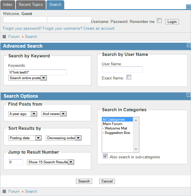

I went to your site ( musictheory.dk ), I entered "link test" in quotation marks but I did not get a browser crash. This is, instead, what I saw:
Is this what you are referring to?
Similar result when I went to another site ( revistafisicoyfitness.com ) and I entered "much improved" in the search keywords field. I do not understand what kind of browser crash I am expecting to get.

Grubbe wrote: Sorry for being unclear. I did not talk about the Kunena search, I talked about the Joomla Site Search.
So may have a problem about the Joomla Smart Search? Did you read the important notice at the top of this page? This is the Kunena forum; this is not a forum for Joomla support.
It's possible that Kunena causes issues with Joomla Smart Search but I do not know too much about this. From what I saw, however, it looks like you may have PHP magic_quotes_gpc setting off (instead of on) which is a hosting issue - something you need to discuss with your webhost.
The website at revistafisicoyfitness.com is really slow - Kunena page load times of 4+ seconds - which indicates that your site must be doing a lot of additional processing in order to render the pages. The problems could be related to the t3-assets template that you are using. Whatever is happening, both sites exhibit signs of Javascript issues and I don't know what are the exact causes of these in the two examples you have offered.
Perhaps someone else who is using the Joomla Smart Search feature can confirm this to be a bug/defect; I do not know how Kunena is involved in this matter.
