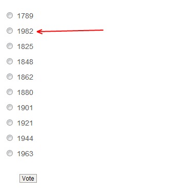

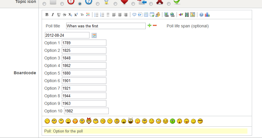

ok, tested again and have taken screenshots showing what happens to make me want to edit my poll and hence destroy the poll and make it disappear
Poll creation i type this:
and then i click submit and it shows like this:
looks like there is a bug :whistle:

14 years 3 months ago - 14 years 3 months ago #131828 by sozzled
peetree21 wrote: ... looks like there is a bug
Well, yes there's one defect you've found and maybe the original question could be considered a defect or it could be considered something like "once you've created a poll then you shouldn't change it".
Looking at the second issue that you've discovered, the order is not random. The order is based on the way the poll options are sorted. SQL is not very smart here: option 10 sorts lower than option 2, like this
1, 10, 2, 3, 4, 5, 6, 7, 8, 9
So that explains one aspect of the problem and, in this regard, it's a "bug" (strictly-speaking it's a design flaw). This defect only manifests itself if you have more than 9 options. Therefore, for most forum "straw polls", most people will never see this happen (especially when you consider that the default configuration setting is for a maximum of 8 options). Therefore, unless people change the configuration, this too is also fairly unlikely.
The question is, what do we do about it? The answer is to report it on GitHub. I have done this for you: github.com/Kunena/Kunena-2.0/issues/1041
