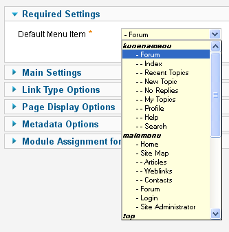

I've been testing this for a while now today ( Joomla 2.5.6 / Kunena 2.0.1 ).
If the Kunena menu is set to forum, see my example images below, no redirect occurs when clicking on the /forum (root) link in the forum pagination menu.
With Joomla SEF / Kunena SEF urls enabled and default kunena menu item set to forum :
Pagination link = /forum.html
[Itemid] => 501 [option] => com_kunena [view] => category [defaultmenu] => [layout] => list
Index link (kunena menu at the top of the forum) = /forum/index.html
[Itemid] => 502 [option] => com_kunena [view] => category [layout] => list [catid] => 0
If the Kunena menu is set to another default menu item such as index, then the redirect kicks in.
That's all I know so far.. :silly:
