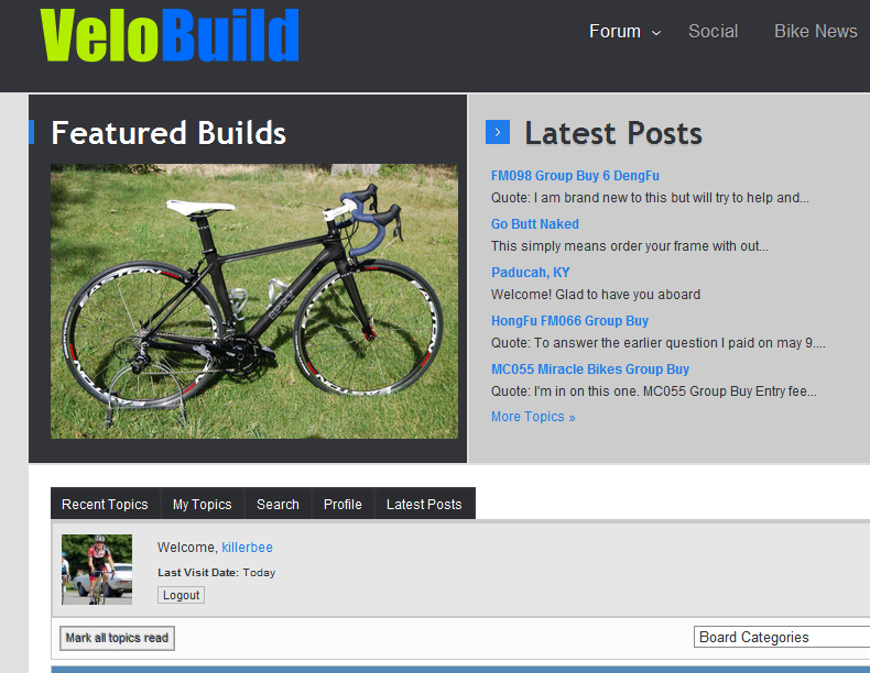

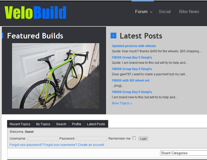

1) Yes, ONLY my own posts show up when I am logged in. The same for other test accounts I have set up. When logged OUT all posts show.
2) The "Topics" headers show up no matter which setting I change in the module back-end.
3) The "Posts" text is not linked as before.
4) I only wish the newest "Posts" to show as I had in version 1.7.2 No "Topics" headers.

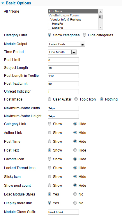

Steps taken:
Uninstall and re-install module.
Cleaned caches - turn off cache
Change every parameter in every configuration possible.
Installed a new template.
Updated everything in my system except for Phoca Adsense 1.6
My latest settings for the Latest Module:
Front Page when Logged in:
Front Page when logged OUT:
