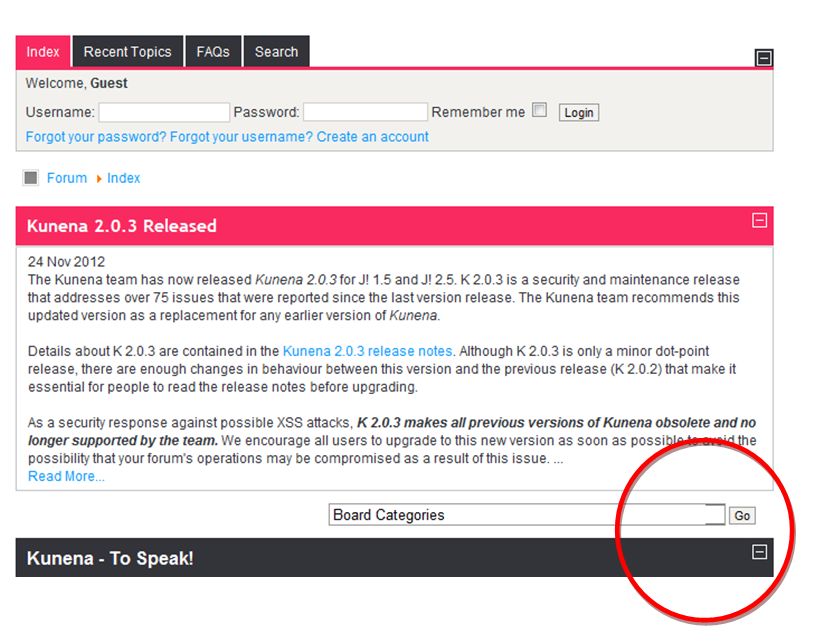

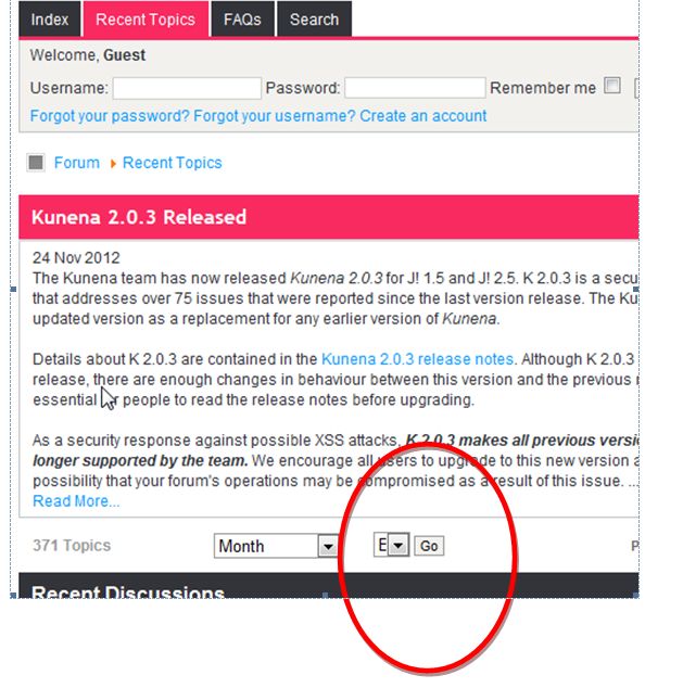

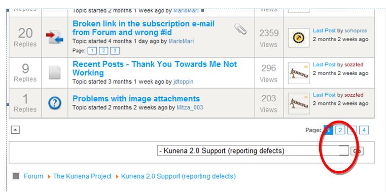

As on this actual page, I have a misformat on some of the listboxes.
Have used standard install.
Actual attachments are from this forum.
1) Recent Topics
2) Index
3) Forum
Last edit: 13 years 5 months ago by olef. Reason: missing attachments

13 years 5 months ago - 13 years 5 months ago #137473 by sozzled
IE8 is a pain!
The problem is not caused by Kunena itself. In this particular case, the problem is caused by the Joomla site template CSS*
There's an easy fix for this issue. Add the following lines to the end of your Joomla site template CSS:
#Kunena #jumpto .inputbox { min-width: 150px; }
Even though it has been the intention that K 2.0 would be compatible with IE8, sometimes not all things can be achieved easily. The good news is that K 3.0 will not make any special provision for IE8 compatibility (in the same way as these things were attempted in K 2.0).
*No Joomla website is immune to the my-Joomla-site-template-can-make-a-mess-of-Kunena phenomenon; this website is also affected. However, even thought I have written that no website is immune from the effects of your Joomla site template CSS, not all installations of Kunena will be affected in the way we have seen in the image above. It all depends on whether you are using a Joomla site template like the one here (at www.kunena.org ), whether you are using IE8 and whether you want to do something about it.
