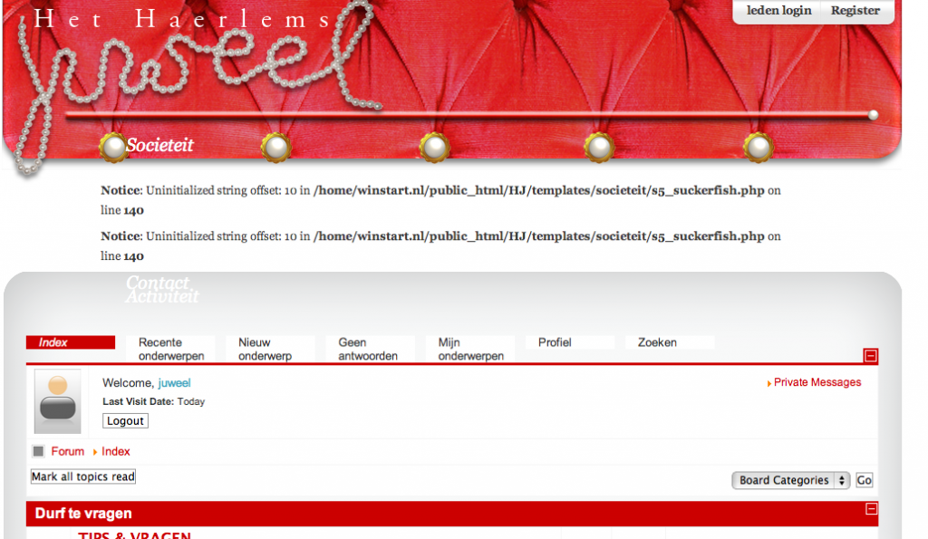

after updating de kunena module my css main menu gives problems, i get the following fault:
Notice: Uninitialized string offset: 10 in .../s5_suckerfish.php on line 140 and my template menu is messed up.
Only with the pages which have the kunena menu

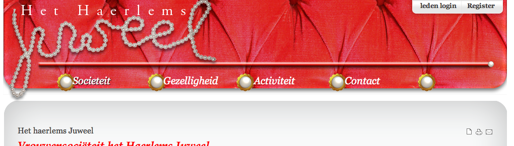

14 years 1 month ago - 14 years 1 month ago #134094 by winstart
hereby i send you a screenshot of the normal menu and the menu with the interfering of the kunena menu
www.winstart.nl/HJ/index.php?option=com_...temid=64&layout=list

14 years 1 month ago #134099 by kiwi3685
I can understand your assumption, but if you study the way that Joomla and Kunena code is processed on your or any site you will see that the problem can only be caused by the reverse of your suggestion.
Your main menu template is in conflict with the Kunena menu.
There is code in your custom Joomla template that is making it incompatible with Kunena.
The only people that would be able to fix this are those that wrote your Joomla template.

14 years 1 month ago - 14 years 1 month ago #134372 by sozzled
Yes. Perhaps I should have helped put you out of your misery in the first place by saying that it was evident you have a JavaScript library conflict issue. You may need to make a choice: your suckerfish-driven menu system or Kunena. Your menu system is incompatible with Joomla Mootools. Please read msg #1 of uBefore you post your question, read this first .
Try re-installing K 2.0.2 again.
