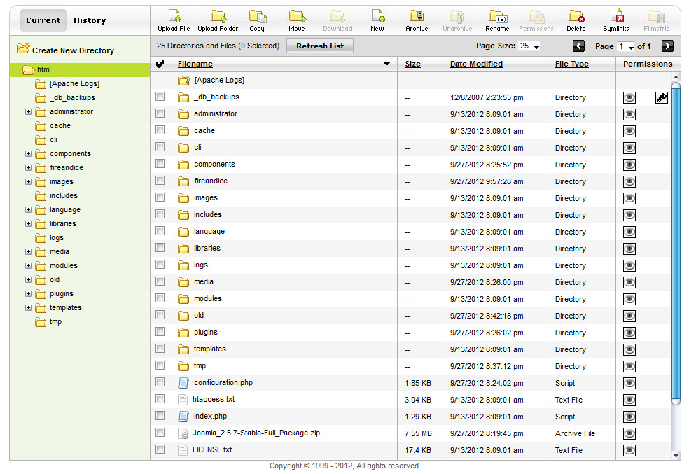

No I don't. Here is a view of the file folder on the server.
