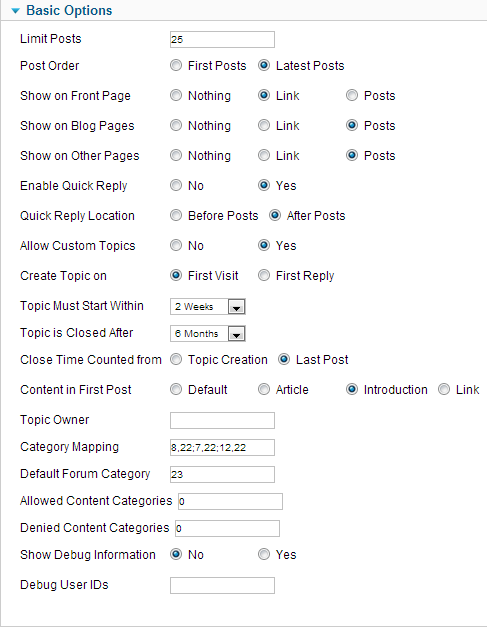

tnx sozzled as usual your very thorough.. there is a LOT covered here so I'm going to have to digest it piece by piece. Not quite sure why "non-standard" kunena menu as I"m 99.9% sure I've not changed it. And as for the template afaik its a standard 3rd party template from kunena shop but again, I'd need to check. One of the things I find strange is that this is was discovered during trying to figure out why articles were not saving due to mod-sec. This is an older site and has been touched by jupgrade though I thought we had cleaned everything out from that. I know now we didn't but I think we've finally got the assets table fixed.
The site template is badly in need of an update and we're in the process of doing so. Which is another thing that brought this to light. I'm not please with the JA template for reasons I won't go into here so I'm having to basically start from square one.
Jomsocial IS very actively used on this site. I'm debating wether to continue that or go back to CB but this time add GroupJive.
This shows the current config for KD.
Thanks for your help. I hope we get this figured out for all.

As far as your Kunena Discuss plugin settings are concerned, compare and contrast those against what I displayed in Kunena Discuss "quick and dirty" instructions for use . I hasten to add that, if you discover that using the settings I described in that topic, if the HTTP 500 error goes away, then we have to investigate which setting(s) is/are responsible for the error condition.
