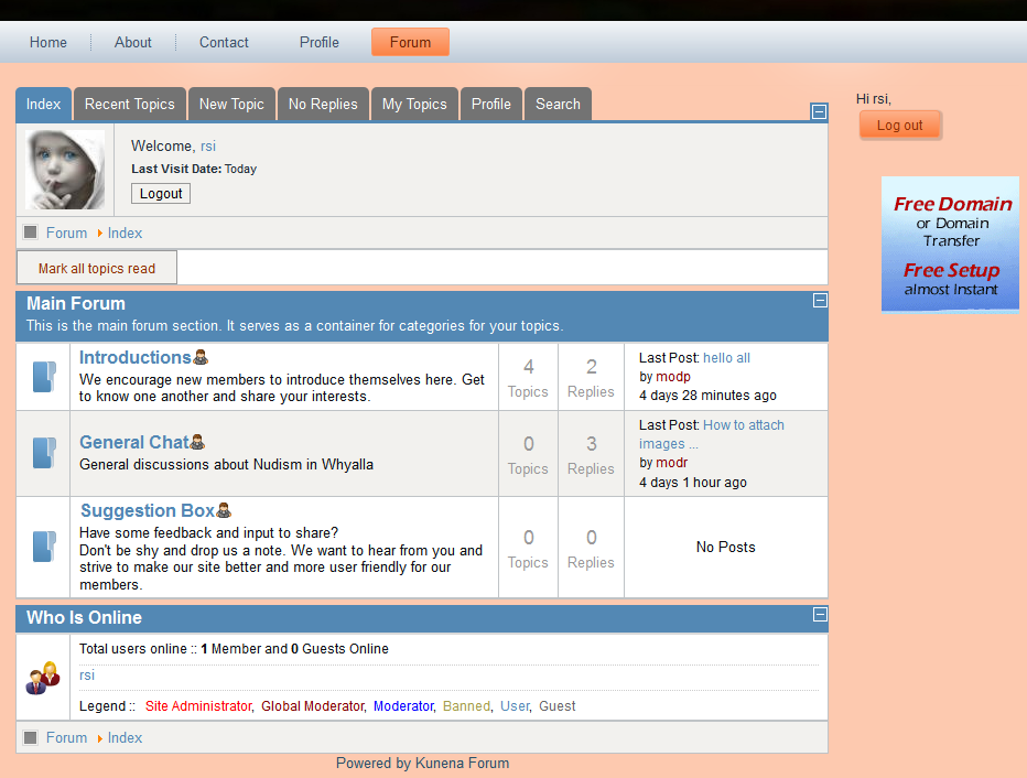

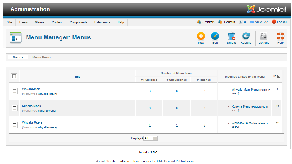

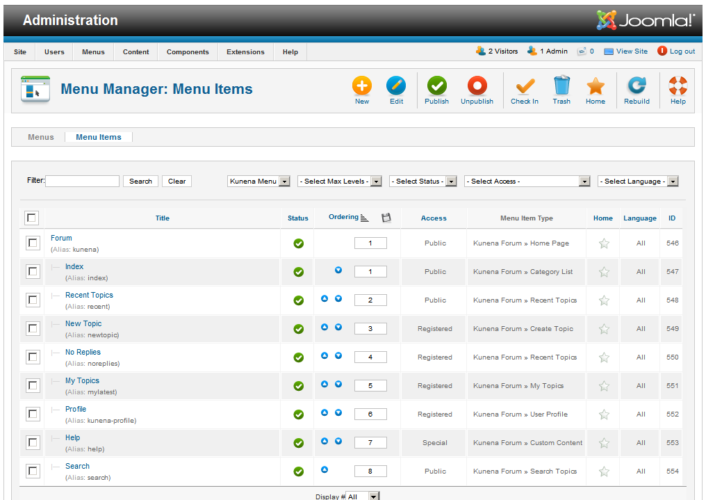

I only have 3 menus in my Joomla installation (Whyalla-Main, Whyalla-Users & Kunena Menu). From what I am understanding the Kunena menu may be being displayed in two locations (in user3 next to the other two menus) as well as at the top of the forum. In the user3 location it is configured with 'Show Sub-menu Items' = no. Whyalla-Main has the Home, About & Contact buttons. Whyalla-Users has the Profile button. The Kunena menu is the Forum button.
With the exception of the '500 Error when moderator deletes (unapproved) topic' everything is pretty much is working as I would want it to. If I have to live with it. Though I'm still confused as to how or why it's all working so well (except for this error) if I've got it set up incorrectly.
Please see the attacments below:
