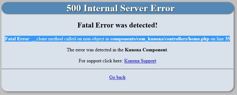

Hello
I have the same problem next my update in version 2.0.3 (See the attached file) :S
And the component kunena disappeared from the list of components... :(
With the old version of kunena (2.0.2), the ID for the component kunena was 10115 in the extension table.
After the update the number changed in this table : ID=10169
Why ??????
I put back the old number in the table (ID=10115) and everything works ! :)
Good but what is the real problem ?
Why the ID is changed ?
Why had I this problem and not the others ?
Jean-Marie (From France)

I'm using the Kunena 2.0.3 and I'm all times getting the same annoying error 500 and by giving a look at the error_log file it shows:
[04-Dec-2012 01:53:20 UTC] PHP Fatal error: __clone method called on non-object in components/com_kunena/controllers/home.php on line 35
by checking the line 35 into home.php file it has the following line command:
$default = clone $menu->getItem ( KunenaRoute::getItemID("index.php?option=com_kunena&view=category&layout=list") );
Does anybody have any idea how to fix it to stop getting the error 500?

13 years 11 months ago - 13 years 11 months ago #137570 by iLucato
Replied by iLucato on topic error 500
Ok, I think I just got the solution by myself. Thanks to the comment in the code "// There is no default menu item, use category view instead" :0)
Let me share the solution. I hope so...
By reading the comment I remembered that I had removed the whole "Menu Kunena Menu" because my blue_eagle was using top menus instead. So to fix what the error log was informing, I went to the Kunena Forum Tool/Menu manager and recovered the "Menu Kunena Menu" from the trash. After that just unpublished all.
So, it isn't giving the error 500 again for a while.
Let's see if it will remain with no error. ;0)

13 years 11 months ago #137641 by iLucato
Argh!!! The issue remains with the same log error as mentioned above!

13 years 11 months ago #137657 by Matias
Replied by Matias on topic error 500
The bug has been reported in here. I'll try to fix it for the next version.
github.com/Kunena/Kunena-2.0/issues/1217
