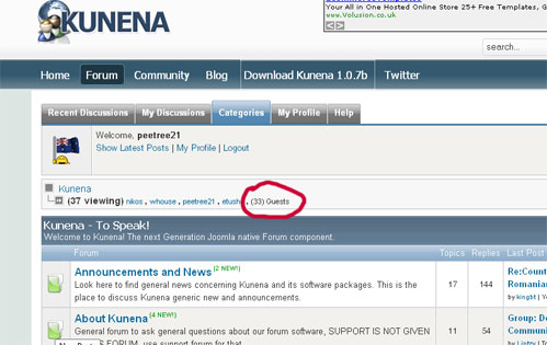

Hi, in my FB1.05RC2 I had this bug and im not sure if it still in Kunena.
I had my board set so only registered people could view it. If you tried click on a post in a latest post module or clicked the forum menu item you were taken to the you are not logged in, you need to log in to view this page screen.
So my question is how come in my board i would still see that there were 'guests' viewing the forums, when there is no possibility that a guest could view it, only a registered user.
ive attached an image showing what i mean. thanks

17 years 9 months ago #1043 by Matias
Kunena seems to make session for users even if they have no permission to see any forums. So when you enter to the forum, it will mark you as being in the main page. When it looks who is browsing on main category, those unregistered users will show up -- even if they see nothing.
Yes, there may be some room of improvement..
