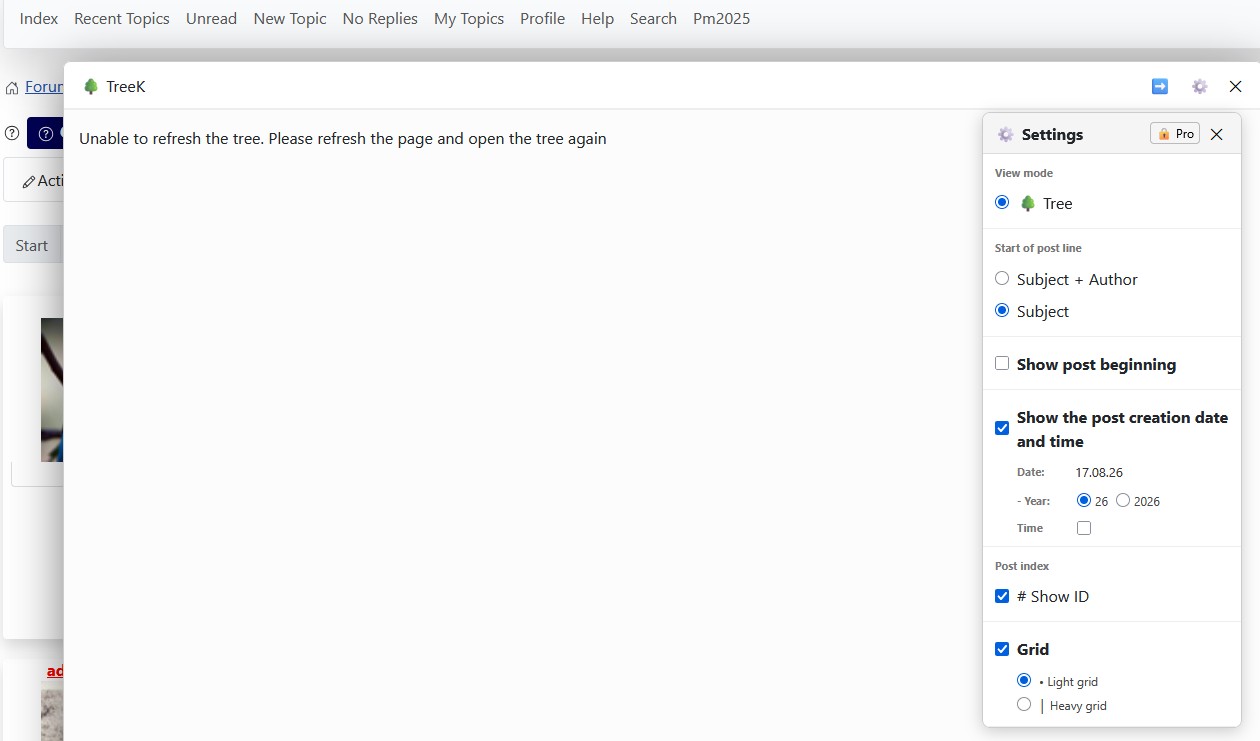

Hello, I have a quick question about tree tree
if I get this "Unable to refresh the tree. Please refresh the page and open the tree again"
message when I click on tree boom
where should I look for the error, if any?
With kind regards
Leen
