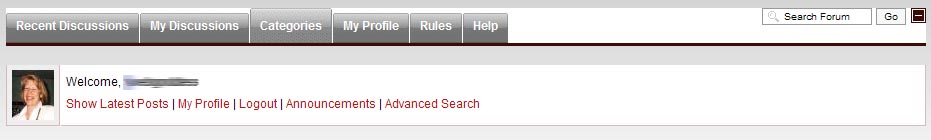

I've got K 1.5.12 installed along with uddeIM 2.0. (No CB, JS, or anything else and no Rocket Theme!) Darned if I can get the "Private Messages" link to show in the profile box as it does in this forum. (Screen shot attached) No documentation to speak of on Slabbi's site and I've searched forums here looking for info without success.
Kunena is configured with uddeIM as the private messaging system and I'm 99% sure that I've set up both components correctly. (It's the remaining 1% that's starting to worry me...)
Would appreciate your assistance if you're able to provide same. If I need to add code to display the link in the profile box, I'll have to uninstall uddeIM. I'm just an Joomla user, not a coder. <sigh>

As far as your questions about integrating this template with uddeIM is concerned, the private messaging system is accessed from the user profile appearing on the right side of the messages. You access the PM function by clicking the glyph. You need to be logged-in to see that glyph/image/link. You also need to change a configuration setting to tell Kunena that you're using uddeIM. Does that explain things for you?
To put a PM link in the profilebox at the top of the Kunena page will require a code hack. [strike]There isn't a PM link in the top profilebox display area here, in this forum, at www.kunena.com .[/strike] I was wrong - there is! :blush:

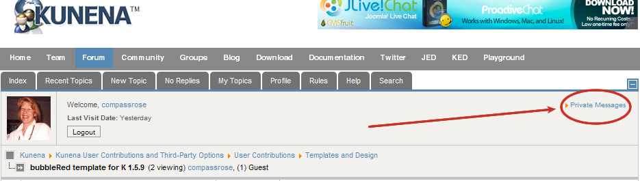

What I'm looking to do is replicate the profile box (perhaps I'm using the wrong descriptor?) as displayed on forum.kunena.com:
This is very confusing. Are you telling me the Kunena forum template (which I assume is default_ex) has been hacked? Or is there a social networking component active on forum.kunena.com that's pulling in the Private Messages link? The link appears to be: www.kunena.com/component/community/inbox?func=listcat . So is it Community Builder that creates the link in the profile box?

compassose: The image you showed in your last message is taken from this website - which uses K 1.6. Yes, the Kunena website uses a social networking product (JomSocial) and no, the "private messages" link in your image is neither a feature of K 1.5 nor is it something that I've done anything about with my bubbleRed template.
