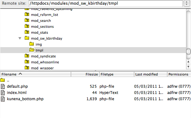

root/modules/mod_sw_kbirthday/tmpl/
root/modules/mod_sw_kbirthday/tmpl/default.php exist.
Both exist and are chmod 777.
I have updated this site from 1.5.9 to 1.5.22 on localhost. Then I have uploaded the site through ftp. Adjusted the configuration file and imported the database in php MyAdmin.

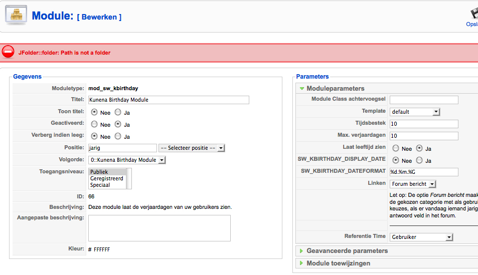

Hmm just trying to understand what the error cause, because i can't reproduce it atm …
Do you get a dropdownlist for the different templates which are in root/modules/mod_sw_kbirthday/tmpl/ or is that list missing??

Yes but is there a dropdown in die modul config where you can choose those templates?
Which Server do you use? Apache or IIS?
And which Patch is shown in the Error? JFolder::folder: Path is not a folder Path: ???????

I really would like to know what the problem is … Could you turn on debug mode and look if you find some further information. If I know WHICH path is wrong I could fix the issue …
Do you installed any stuff which change joomla? Your Gegevens (Details?) looks so different to a normal Joomla Module Config view …
You can also try to open mod_sw_kbirthday.xml, find this line
and change it to this:
or this
or this
That is the only place where JFolder is used by joomla and I only can say what'S wrong when I see the Path which Joomla means to use on your system …
description="SW_KBIRTHDAY_TEMPLATE_DESC" directory="modules/mod_sw_kbirthday/tmpl/"
description="SW_KBIRTHDAY_TEMPLATE_DESC" directory="modules/mod_sw_kbirthday/tmpl"
description="SW_KBIRTHDAY_TEMPLATE_DESC" directory="/modules/mod_sw_kbirthday/tmpl/"
description="SW_KBIRTHDAY_TEMPLATE_DESC" directory="/modules/mod_sw_kbirthday/tmpl"
