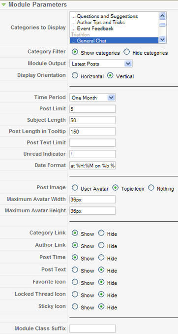

15 years 6 months ago #81921 by andy bonner
Here they are... I just don't get the logic of it working on one page, but then not on another...
I'm trying to think of the differences between the pages - The one it doesn't work on does have the excellent 'Kunena Comment' plugin (sorry I forget it's exact name but the feature allowing comments on articles and connecting them to the forums)
15 years 6 months ago #81922 by mibert
Hi Andy,
sorry I have no idea. Seems to be set correctly.
Only one thing, which came to my mind is the different templates, which you are using on your site.
I realized, that the Forum and the Latest Post module at www.caymanactive.com/dt2 are using the same template and are working. The other page, which you also use the Latest Post module has another template and is not working.
Perhaps you could try to use the same template allover your website and check if that helps.
Beside this I have no idea.
Best regards
Michael
15 years 6 months ago #81954 by andy bonner
Making Progress solving this but need help in the final (!?!) solution...
a) I tried the template theory - but changing template back to the default didn't help - Still not showing the posts.
b) On further investigation I've narrowed things down - If the module is on an article view page it doesn't work for me - if it's on any other page eg component view, category blog view, then it works fine!
So why would a standard Joomla article view page stop this from working and how can I fix it?!? (I use RocketTheme Paradox template - which probably has an override for the default article view page - but I'm sure if I asked them they'd say it was a Kunena issue?)
Can anyone else get the Latest Posts to show as a module on an article-view page?
