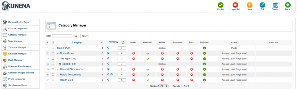

Hello again,
I am not quite sure why you said I don't have any categories created. I actually created all the categories under the Main Forum which was listed as a section. In any case, to be double sure, I have created a new section and moved the Herald Discussions category to it. It is still not happy.
Pls see attached screenshot.

14 years 8 months ago #120274 by lurd.sammie
Found the cause of the problem. In the end it was a very simple oversight. The problem is because I recreated the articles from the live site odadee83.com , I have set the creation date back to January while in the kunena discuss plugin I had set the Topic Must Start Within: to only 1 week.
I have now set it to 6 months. And voila! its all working now.
Thanks for your time and effort.
