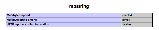

I relayed what you said to my host who has replied as follows:
"PHP has been built with mbstring turned on. I would recommend you checking back with your developer. To verify mbstring has been turned on please see the following link"
I checked the link provided (on the shared server) where it is clearly visible that mbstring support is enabled. See attached.
Please advise

I mentioned earlier that I checked with my host who confirms that mb string multibyte support is turned on.
Please advise

Hi Sozzled. Thanks for your reply. I cloned the site and installed on a separate server where the error message disappeared. I relayed this to my host who investigated further and responded as follows:
"I understand this is frustrating, but I have confirmed yet again that this is a coding issue and will need to be resolved by your developer. The error indicates that the function is not being passed an offset as expected. You can verify mbstring is enabled here: panther.directrouter.co.uk/php/
As for comparing servers that's not a useful metric as the other server could be using an outdated PHP release which doesn't require the same number of parameters."
(The other server is indeed using an older PHP version 5.2.17).
I feel a bit stuck here in the middle. You guys say one thing and my host says another. Can you please advise what I might be able to do to resolve this ?
