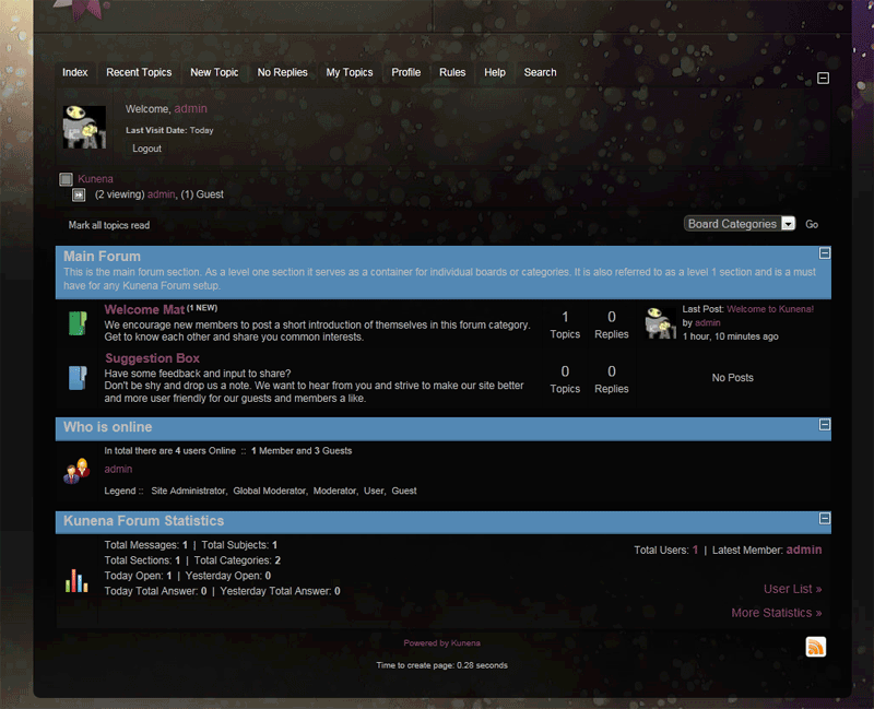

The only issue I am having is when I edit the header bg colors in the Kunena template manager it has the negative effect of changing the link colors to that same value.
I would like to separate the two if I could so I can keep my forum link colors consistent and get rid of the ridiculous blue background that the headers are currently using...
I am using the default template with the "Blend with Joomla Template" option enabled.

I'm having the same issue, I think the skinner overwrites the existing line and replaces it with a inherit or whatever code is used for the blending, I just cannot locate where it is. I think removing that code wouldn't damage anything with the blending and would allow the manual adjustments to the template to be active.
15 years 6 months ago - 15 years 6 months ago #95289 by xertox
I think I got it figured actually. If you are still having the same issue look for a PHP file in /components/com_kunena/template/default/css
The file I edited was css-62df8d6e67d54b79e4e9814ce815e8ab.php (it contains all the same CSS info as the style sheets themselves)
I did a search for kheader in that file and changed the hex code to my desired bg color and it worked.
