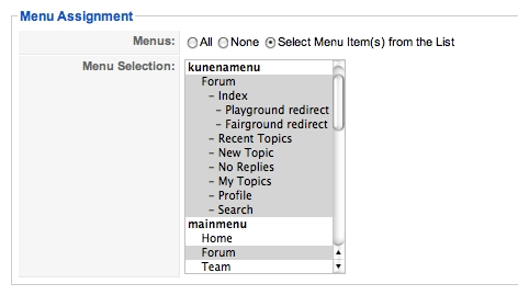

15 years 11 months ago #70295 by fxstein
Matt,
This is controlled from within Joomla. Any module you want to show on the forum pages, you need to make sure that all the forum links are highlighted in the module-menu assignment.
Here is an example:
Modules are only shown on pages they are assigned to (or ALL).
Hope this helps!
15 years 11 months ago #70296 by mattlindsay
Hey, thanks fxstein, but this is how I have configured Joomla (and hence I do have the module when you go to the forum. Its only when you click one of the kunena tabs that it disappears. Have a go for yourself.
Matt
15 years 11 months ago #70297 by mattlindsay
Oh my good lord!!
OK, I hadn't realised, but when 1.6 installed, it created "sub" entries in that section (as you showed in your image). I hadn't gone back in and selected them (dont think they were available in 1.5.9). All sorted.
