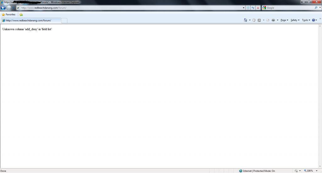

Here is the entire error.
I am using the SEO that came with Joomla in Global Configuration.
I did some playing arround and noticed that this only happens with the URL www.mysite.com/forum/ . This is the URL that SEO creates for the forum menu item. It also appears that the Kunena Latest mod is generating this error with every link. If I type in the URL www.mysite.com/fourm the SEO will rewrite the URL with the "/" at the end and it Dies. If I type in www.mysite.com/forum/index with no tailing slash, everything work fine. I have tried this with the default theme, and the same result.

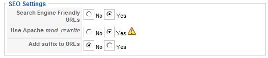

If I disable "Use Apache mod_rewrite" then the forum links and Kunena Latest links work. The only problem is that with Use Apache mod_rewrite disabled the menu item "Forum" looks like this... "/index.php/forum/index?view=listcat&catid=0&func=listcat"
15 years 10 months ago - 15 years 10 months ago #79429 by sozzled
gomangodave wrote: If I disable "Use Apache mod_rewrite" then the forum links and Kunena Latest links work. The only problem is that with Use Apache mod_rewrite disabled the menu item "Forum" looks like this... "/index.php/forum/index?view=listcat&catid=0&func=listcat"
Did you hover your mouse over that warning icon on the Global Configuration screen? Did you read the tooltip? What did you use for your .htaccess file?
However, this does not explain the "Unknown column 'add_deny' in 'field list'" messages. Where are these coming from and when do they appear?
