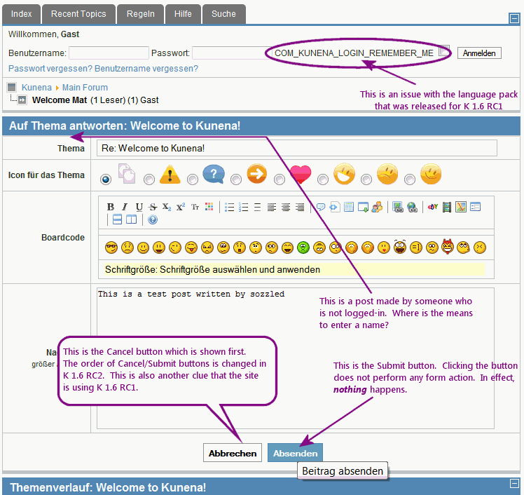

Question K 1.6 RC1: Submit button does not work for public posts
Please, whenever you request support for problems, include details about what version of Kunena you are using. It will save your time and our time if we don't have to guess what version you are using. Please use the Configuration Report feature and provide us with information about how you have set-up your installation of Kunena.
The problems that you have described affect K 1.6 RC1. I suggest you wait until RC2 is released to see if those problems have been fixed. In the meantime, I will ask the development team to look at this discussion topic. Thank you.
See also COM_KUNENA_LOGIN_REMEMBER_ME
Then I replied to my topic -- it worked.
It looks like the bug has been fixed for RC2.

On many levels, your problem is not the same problem; it is a new problem. The original problem involved K 1.6 RC1;your problem involves K 1.6 RC3. In the original case, the problem involved Firefox; in your case it involves Google Chrome.Topics that are moved into this category are generally considered to be closed. Users may want to add additional information but these topics should not be resurrected in order to discuss new problems or unrelated matters.
Please start a new discussion topic called "K 1.6 RC3: Google Chrome: Submit button does not work for public posts" and we look into that problem.
In the meantime, I suggest that you read the very important information about Legacy Mode and eliminate that as a possible cause.
