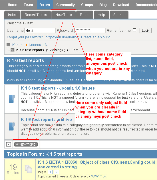

16 years 1 month ago #56091 by Mortti
I reproduce Admata settings one of my test site (Public Read/Write - Yes,Registered Users Only - No,Allow Nickname on Posts - Yes and also enabled anonymous posting in one test category).
A picture tells, which might cause confusion for the users when they are not logged in the forum (two different ways) if someone use this kind of settings anyway :)

16 years 1 month ago #56098 by Admata
Mortti wrote: I reproduce Admata settings one of my test site (Public Read/Write - Yes,Registered Users Only - No,Allow Nickname on Posts - Yes and also enabled anonymous posting in one test category).
Thx Mortti. I understood the word anonymous a bit different than what it is in Kunena. I mixed the meaning simply to write without logging in, to write as a guest. Anonymous posting in Kunena leaves no marks, no ip-addresses even to forum administrator. (This thing have been asked in this forum.) Actually I don´t really want to allow that in my forum :blush:
Seems to me that you cannot write and reply as a guest by using normal buttons in Kunena 1.6 RC1 - at least not without a some kind of a hack? :dry:
