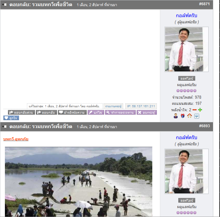

Replied by Matias on topic Re: please help after i attached an image. The content are not display (see picture)
I think that these two issues are separate.
In order to find out why text isn't showing up, you need to create another text topic and paste all text from the broken message into there. Then just edit the topic and remove a few lines until you find out what is causing this bug to happen.
