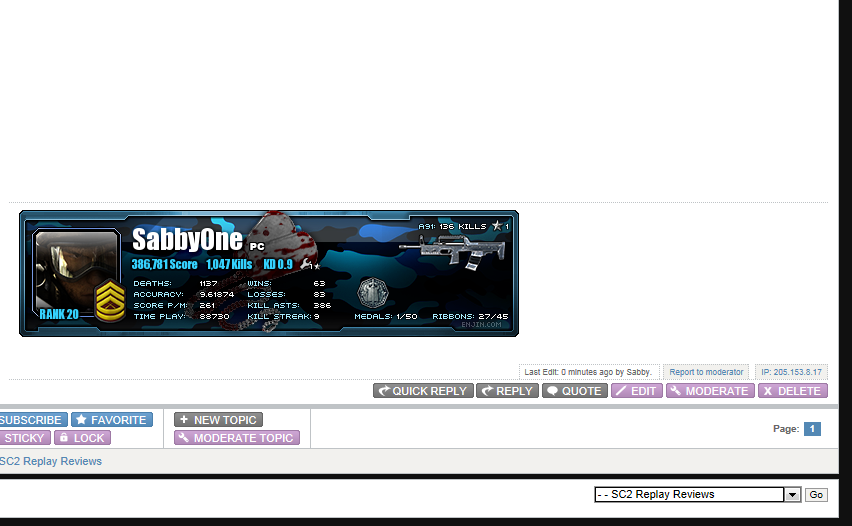

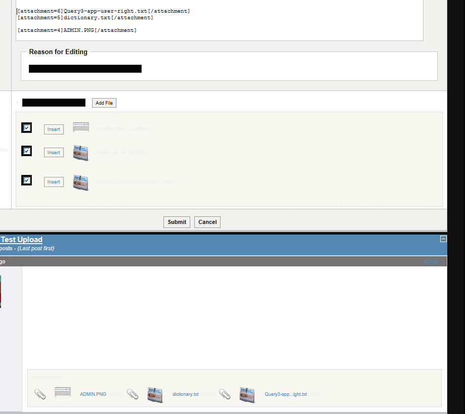

Here are a couple of images that show whats going on.
Image one, I am editing a post with attachments and you can see that they show up in the preview. This is the default template.
Image 2 shows what it looks like from the forums, you will see no attachments.\
