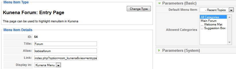

The Kunena entry menu item is:

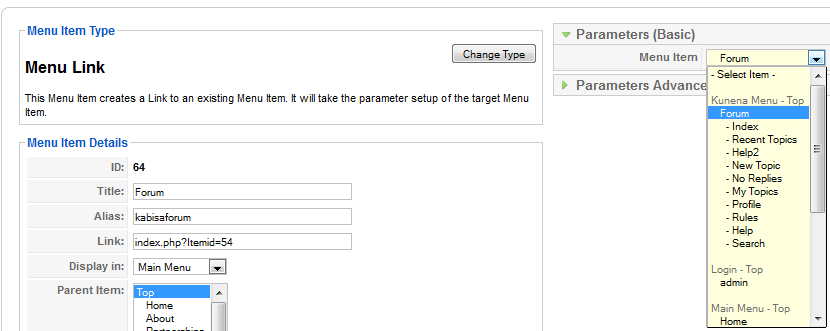

I tried changing the alias in case there was a clash between the two menus with identical aliases. I have also checked that there is no folder with the same name as the alias. Nor is there a folder called \forum
