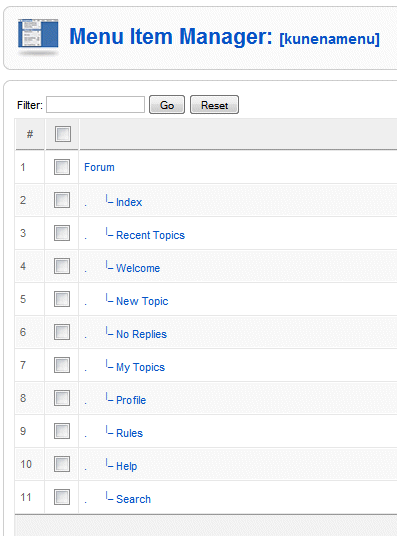

I have the answer for you. Yes, the K 1.6.0a menu is a bit "restrictive" in this regard, but there is a very easy solution to the problem.
When K 1.6 is installed, the installation process creates a Joomla menu (menu type = kunenamenu) as the following screenshot shows:
When you inspect the menu items in this new "Kunena Menu" you will see the following structure:

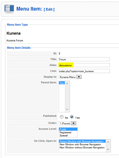

The issue that you are having is caused by the name of the first menu item. All you have to do is give the "Forum" item a new name (or a new alias, like I've shown in the following image) and your worries are gone. B)
Last edit: 16 years 4 months ago by sozzled.
16 years 4 months ago #51142 by kross76
I see, and I've tried it. It's fine. Thanks. And the ability to rename the other top menu items will be an excellent feature too.
