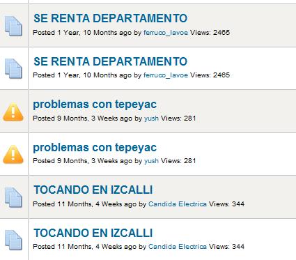

Hi
My forums show lastest post, with incorrect data, is not showing latest post
If I do a recount, it don't solve the problem
If i do what was posted here:
www.kunena.com/forum/139-solved-or-prior...gory-recount-problem
If you do not have subcategories (just sections and cats in there), try to run these queries:
INSERT INTO jos_fb_users (userid, posts) SELECT userid, COUNT(userid)
FROM jos_fb_messages
WHERE userid>0 AND hold=0
GROUP BY userid
ON DUPLICATE KEY UPDATE posts=VALUES(posts);
INSERT INTO jos_fb_categories (id, numTopics, numPosts)
SELECT m.catid, SUM( m.parent=0 ), SUM( m.parent>0 )
FROM jos_fb_messages as m
LEFT JOIN jos_fb_categories AS c ON c.id=m.catid
WHERE m.catid >0 AND m.hold=0
GROUP BY catid
ON DUPLICATE KEY UPDATE numTopics=VALUES(numTopics), numPosts=VALUES(numPosts);
SELECT parent, SUM( numTopics ), SUM( numPosts )
FROM jos_fb_categories
WHERE parent > 0
GROUP BY parent
So, when I enter to a forum, the post seem to appear twice, or duplicated
But with same data and same link, but they are appearing twice
So, I did roll back my site, to previos befor aply those commands
If I uninstall kunena 1.5.7, and install com_kunena_v1.5.8-DEV, and do a category recount, I have the same problem, my post appear twice
In both versions, if I use the mod Kunena-Latest, to show latest post, the data is showing is not the latest, it shows post of two years ago
What else I can do?
Regards
NOTE ADDED: And I can't delete duplicated post, because they are the same, if I delete one, both are deleted
Last edit: 16 years 11 months ago by tenoch.
16 years 11 months ago #33935 by Matias
The fix in the forum works only in some configurations, not universally. :( Real fix was much more complicated.
Which template do you use? Default_ex?
Does your forum work by downgrading to K1.5.6?
Contact me again by PM and provide me admin rights to your (test) site. I'd like to take closer look on what is happening in your site.
