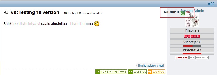

Okey... now that fix cause template issue with karma buttons I think? (default Joomla! and Kunena template)
