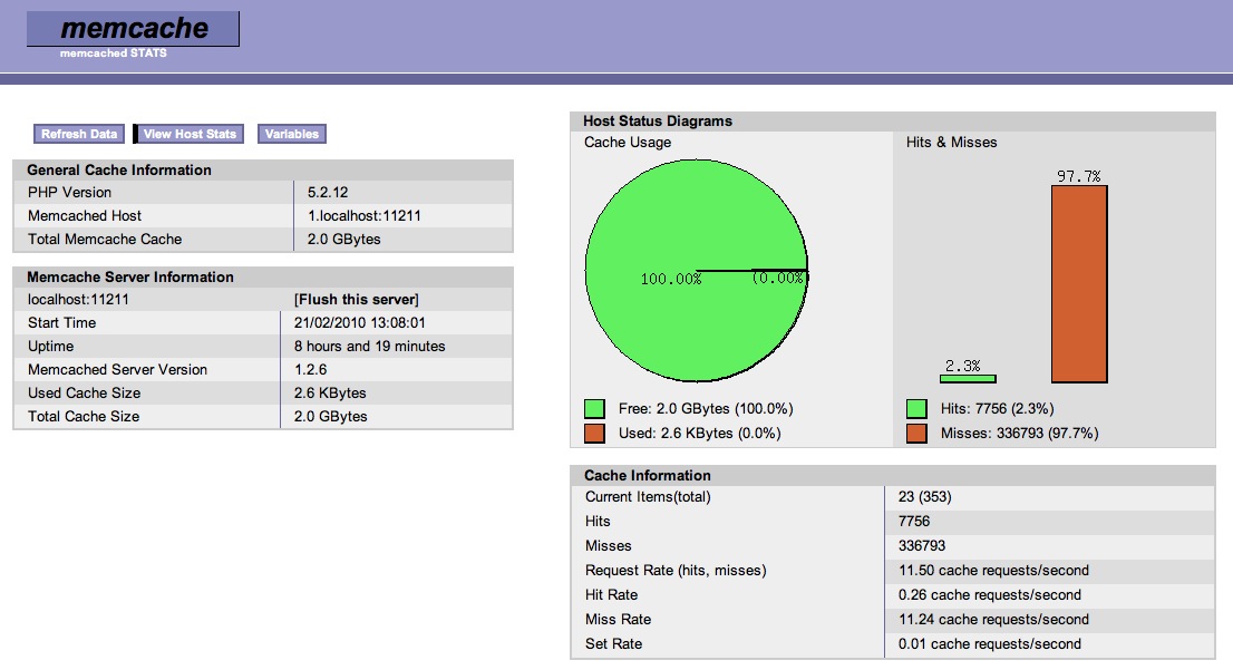

Hi fxstein,
Thanks for your time.
Apache conf:
Joomla setup:
Cache settings:
Handler: Memcached
Persistent Memory Cache YES
Memory Cache Compression YES
Gzip compression ON.
JRE Query Cached 3.2 installed and active
CSSJSCompress installed and active.
Joomla 1.5.14

16 years 6 months ago #40658
by octet
Replied by octet on topic Re:Kunena 1.5.9 performance

Thanks for the additional information. As I thought, your forum is way too small to cause this kind of server loads.
I would go back to the basics. You have a whole list of extensions for various things.
We don't use as single one of them. If you are running on a dedicated server with your own mysql instance, there is no need for memcached either. Please disable it for now - your memcached setup certainly has issues by itself.
Also make sure you do NOT run any third party SEF components like sh404SEF on your site. Work with Joomla SEF if at all possible. The caching of sh404SEF on a site with 50,000+ unique urls would cause the same issue. Most 3rd party SEFs wort great on fairly limited sites, but not when combined with a forum that creates thousands and throusands of unique urls (like for every page of every thread.
You just want to make sure the mysql instance is setup correctly. There are a few tools out there that are very helpful.
Here are two we use all the time to check if our mysql settings are optimal:
www.unix.com/web-programming-web-2-0-mas...uning-primer-sh.html
Both tools should show mainly green for all major setting, with the exceptions of certain joins that will not use indexes.
For example: Our long_query_time log setting is at 1 sec (the lowest mysql allows)
Out of the last 66M queries 16 queries exceeded that
Make sure you run the InnoDB storage engine. It is a myth that MyISAM is faster on larger sites, especially if you need concurrent reads an writes.
With InnoDB, set the query cache to 64-128MB to start with and check with the two scripts after a day or two.
Now - there will always be some queries that cannot use a proper index (in K1.5.9) for joins. The number of those should be relatively low. In our case 4k queries out of 66M (6 days since the last mysql restart), only 39 are doing record by record lookup - these are the ones we focus on to eliminate. The majority of our queries in that category are LIKE %searchterm% search queries. It is certainly a limitation of Kunena and most other forums that certain searches are expensive and will bypass all usage of indices. That is why we are working with JXtended to integrate Kunena into Finder 2.0 that builds a true search engine style index of all content.
Next check your php installation. You should be running either apc or eaccelerator (both open source php accelerators). This can drop the php induced load on a sever to 1/3 or even less.
Since your test returns similar results, I am suspecting one of the Joomla plugins/components to be the reason for the issues. That CSS compressor sounds like it could be a CPU hog if it does realtime CSS compression on every page load. Disable as many as you can afford and check the load on the system.
There is a million things that can be wrong. You can only get there by elimination.
PS: Please update your Joomla install - you are running an outdated version with security issues.

To be clear:
I would get rid of ALL of these to start with:
Joomla setup:
Cache settings:
Handler: Memcached
NO memcached
NO JRE Query Cache
NO CSSJSCompress
uninstall all of them. Then make sure your mysql database is setup correctly (see my prior post).
Once you have confirmed that to work, then and only then you can try APC or eAccelerator of PHP
