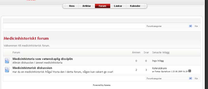

17 years 2 months ago - 17 years 2 months ago #27775 by tomasgusta
Hi 810!
I tried to change the line to:
$catid = '4';
but the forum still starts up in the main forum "medicinhistoriskt forum":
Last edit: 17 years 2 months ago by tomasgusta.

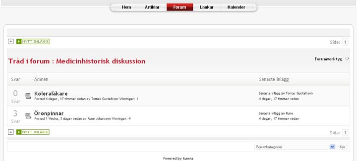

17 years 2 months ago - 17 years 2 months ago #27776 by tomasgusta
Instead I would like it to start inside the category "medicinhistorisk diskussion" as in this link:
medicinhistoria.nu/index.php/forum/4-med...historisk-diskussion
What can be wrong?
Best regards Tomas
